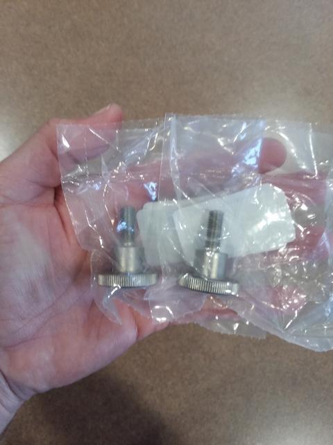

Received the knurled hand-bolts in the mail today.
They look like some nice kit! I think I'mma go out and install them now.

I find it relatively easy to install one, but then the other is a pain to line up. This is true also for the hex head bolt, it's not the fault of the knurled knob. It'll take working out a technique to wiggle the seat into the right position for the bolt to line up with the thread.

What's the verdict on the installation?Tomcatfixer wrote: ↑Sat Jan 19, 2019 5:10 pmReceived the knurled hand-bolts in the mail today.
I received the same bolts today. My first impression is that they are quite larger than the image in the Amazon ad suggested. I'm concerned about clearance issues on the underside of the rear fender.
Comments welcome.

Give it a shot, you'll see that they don't really protrude more than a few millimeters past other things that you would be hitting with your tire if there was a clearance issue.
Someone could definitively measure, but it's good enough for government work.

For the knurl-knobs? Super easy install. For the Enduro seat as a whole? Only issue was that awkward to reach front nut.What's the verdict on the installation?
You needn't be.I'm concerned about clearance issues on the underside of the rear fender.

Thanks, as always, for the empirical evidence (photos). It does matter.Tomcatfixer wrote: ↑Tue Jan 22, 2019 11:07 amYou needn't be.I'm concerned about clearance issues on the underside of the rear fender.
You've ridden with the new bolts in situ, and there wasn't any perceived or observed contact with the rear tire, I presume?

Simples, measure the distance between knurled knobs and tire, then compare with the maximum travel of rear shocks.

Only a proper road test will provide useful data here, Mike. The air space between the fender and the Duro on my unladen rig isn't so large that I shouldn't proceed a bit cautiously here, vis-à-vis being concerned about the protruding length of the knurled bolts.Mr Wazzock wrote: ↑Tue Jan 22, 2019 3:49 pmSimples, measure the distance between knurled knobs and tire, then compare with the maximum travel of rear shocks.
I did attempt to fully compress the rear suspension whilst the bike sits in the garage, but I'm not strong (or fat) enough to do so. Pressing down vigorously on the rear of the Enduro seat simply compressed the outboard shock about halfway, if that; the inboard one moved just a smidgen.
The silver lining here is that Pennsylvania roads are...not the best.

I just thought is a better option than risking gouges in the tire.

I've compressed the rear shocks while they're installed with ratchet straps. The rear only has a few inches of travel. Perhaps next time I do it, I'll take a measurement. Or perhaps it's already listed online somewhere.

An awful lot of faffing about, I thought surely it's simple just to measure between fender and tire, then the exposed rod of the shocks. Not done it mind you.

While that technique would probably get you in the ballpark, remember that the axle is located beyond the lower shock mount and, as a result, it travels a greater distance than the lower shock mount.I thought surely it's simple just to measure between fender and tire, then the exposed rod of the shocks. Not done it mind you.

OK, true, but if say, you did it, and the fender to tire distance was loads more than the shock travel distance, then OK. If both measurements were much closer, then start to worry. But as I said I've not done it (seems simple to me while sitting here in an armchair thinking about it
