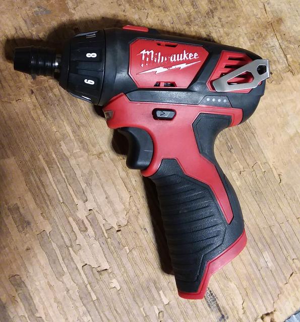

Milwaukee M12 12V screwdriver, Cat. No. 2401-20. I'm fairly well invested in the M12 line, and I've used all of them at least a few times. My go-to tool for most jobs, though, is this reliable little driver. It's more worn than the photo would suggest, and it continues to punch above its weight.

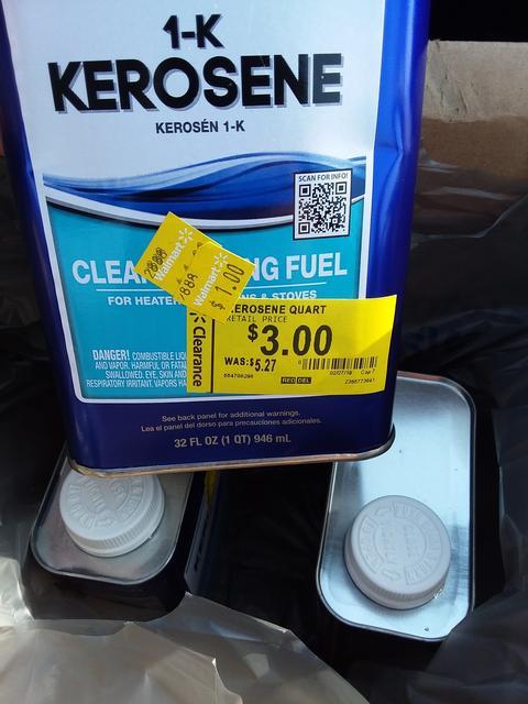

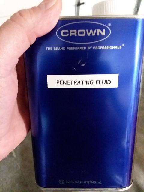

Home-brew penetrating fluid. 50/50 ATF and acetone. I mixed a batch out of necessity when my pricey can of Kroil ran dry. The home brew works just as well as the pro stuff, for a fraction of the price. I discovered that the acetone content, which separates naturally from the ATF, will slowly evaporate from plastic bottles. This changes the mix ratio. I repurposed an empty quart can of kerosene to solve that issue.

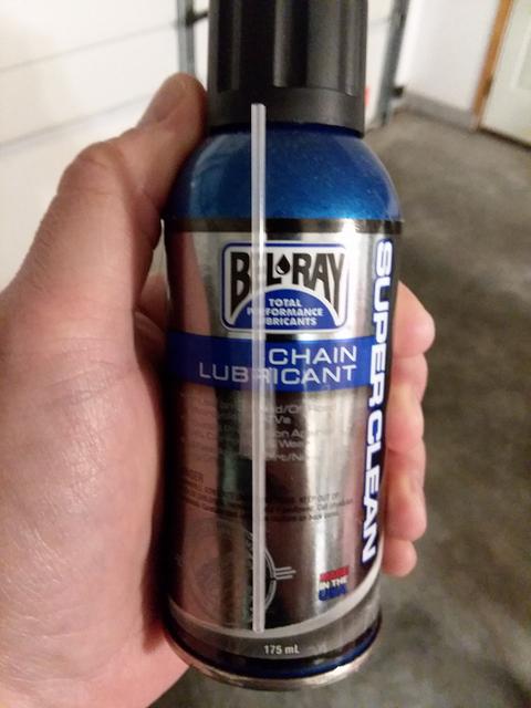

Bel Ray Super Clean Chain Lubricant. I have a small collection of several almost-full cans of chain lube that did not perform anywhere close to the manufacturer's claims. The BR Super Clean lube, on the other hand, doesn't fling off or attract road & trail detritus like the rest. It cost me a few $$ to finally find the right stuff. Here it is.

I read a technical review of penetrating oils including Kroil, and that 50/50 mixture of ATF and acetone came out on top. Haven't needed it (yet), but glad for your confirmation.

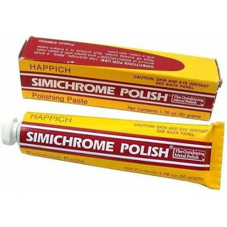

Simichrome: old stand by polish for chrome and aluminum parts.

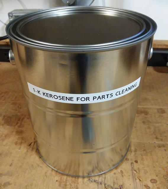

Speaking of kerosene, want an inexpensive and effective degreaser than won't attack rubber parts? Kerosene is my go-to.

Already there, Chad. :wink:
