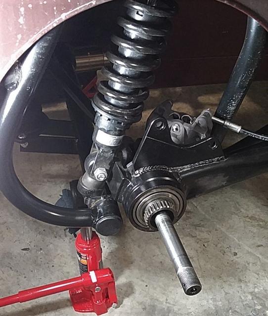

The sidecar wheel spacer(s), if present, are important. If removed, they must be refitted in the same position and quantity as existed prior to removal. 'Twas advice I received just after taking delivery of my Gear Up.
I'm told that the spacers are fitted at Irbit according to individual need (manufacturing tolerances being a bit looser than, e.g., Honda's assembly line.
The spacers slide on and off the axle in a straightforward manner.

I’m still trying to figure out how to post photos so I’ll make this more difficult than it needs to be, I guess. The spacer/washer I’m talking about goes under the castle nut (not shown in your photo) that holds the wheel on the axle. It’s being missing puts a snugged castle at the absolute bottom of the axle threads. So, the cotter pin in its position on the axle was above the top of the nut. That washer’s absence is easy to spot but, I’m told, easy for a dealership rigger to overlook.

On the older rigs there’s a spacer that fits on the axle before you put on the wheel... distances the hub from the bearing... it’s somewhat difficult to get out (and I’m not sure if’n the newer, 3 disc rigs even have ‘em)... if one’s supposed to be in there it’s considered a wear item and will cause the cotter pin/castle nut mating issues yer describing...
Here’s a vintage pick from the Arctic’s past...circa 2009...
Worn spacer on the left... new on the right...

Look at item 10 in the attached parts diagram. There is supposed to be a washer under the castle nut that holds the sidecar wheel on.

Item 18 in attached parts diagram is the distance bushing(IMZ-8.107-05520) that everyone else posted about. It slides on the sidecar axle and fits inside the splined hub. The wheel has to be removed and you look down inside the splined hub to see it. If there's lots of grease it is hard to see if its in there and you have to use a pick to get it out.
Might be a good idea to check if yours in in there as well.

Short answer from me is nothing probably got hurt.
Longer answer/story. When I bought my 2010 used I was checking it out and observed the castle nut was like yours, a few threads from the cotter pin hole. The wheel didn't have any play but I couldn't figure out why it would be designed like that. I made a spacer based on a quick couple of quick measurements and installed it. Then I ordered the correct spacer as I wanted to see if I was on the right track with my shop built spacer sizes. When the Ural spacer arrived I measured it and found I was about 0.007" thinner than the OEM part. I never did install the Ural spacer since what I had was doing the job.
The wheel bearing perload is done with the wheel off the machine using an axle and spacers to get the correct preload. I made the tool and the bearing preload was correct. I have also since made the tool for the front wheel bearing preload check and corrected the preload on my front wheel.
My guess is on your machine having corrected the missing part you will never be able to tell if its missing causes premature failure or wear.
If I was in your situation I would be asking for the mechanic who fixed the issue on any more service encounters and establish a relationship with the shop and that mechanic. Additionally, after you've used the machine for another week or two (couple of hundred miles or so) it could go far if you returned to the shop and let the mechanic know all was well with the machine and thank him for the good work. If the shop isn't nearby a quick phone call will work too. If you aren't a poverty rider it never hurts to slip the mechanic a tip as you tell them you appreciate good honest work when you pick up the machine.

Amazing how much wear goes on. 2018 still uses this spacer. Mine was put on the wrong side and some parts were damaged. Warantee covered parts replaced.S 854 wrote: ↑Sat Nov 09, 2019 1:12 amOn the older rigs there’s a spacer that fits on the axle before you put on the wheel... distances the hub from the bearing... it’s somewhat difficult to get out (and I’m not sure if’n the newer, 3 disc rigs even have ‘em)... if one’s supposed to be in there it’s considered a wear item and will cause the cotter pin/castle nut mating issues yer describing...
