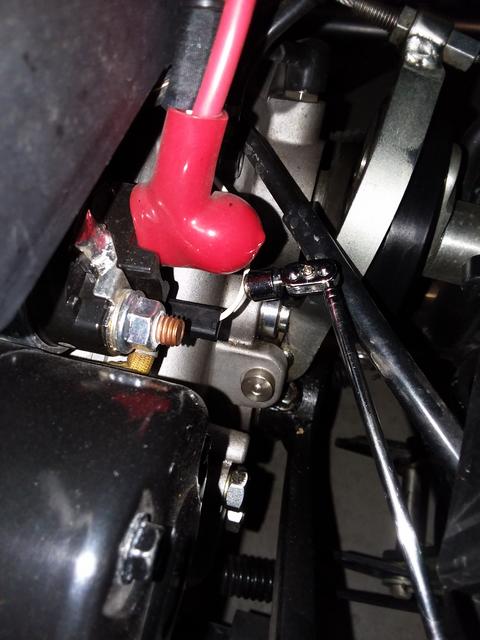

There's a small female disconnect that attaches to a lug on the starter solenoid. If the disconnect fits loosely, it will eventually work its way off, leading to a no-start situation quite similar to what you describe. Check this disconnect for a snug fit.

Could be a sticking starter if is had been sitting prior to you getting it. If you are getting power to the starter when you hit the switch, tap the starter with a soft hammer while holding the starter button down. If it starts to crank when smacked, the starter is the issue.

It could also be contamination on the solenoid contacts. If you hear a very audible click near the starter but it doesn’t “turn over” press the starter button several times in rapid succession and that may shake the contamination off of the contacts. My 2015 had a similar issue that was contamination related, it cleared up on its own.
