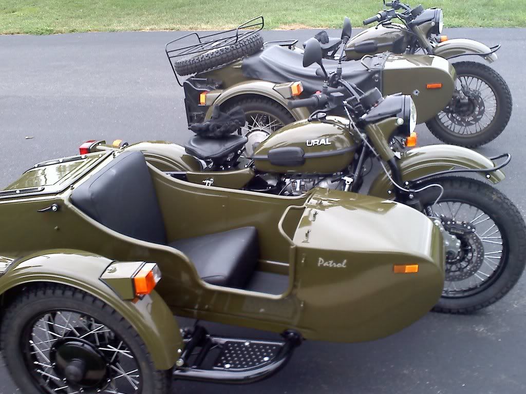

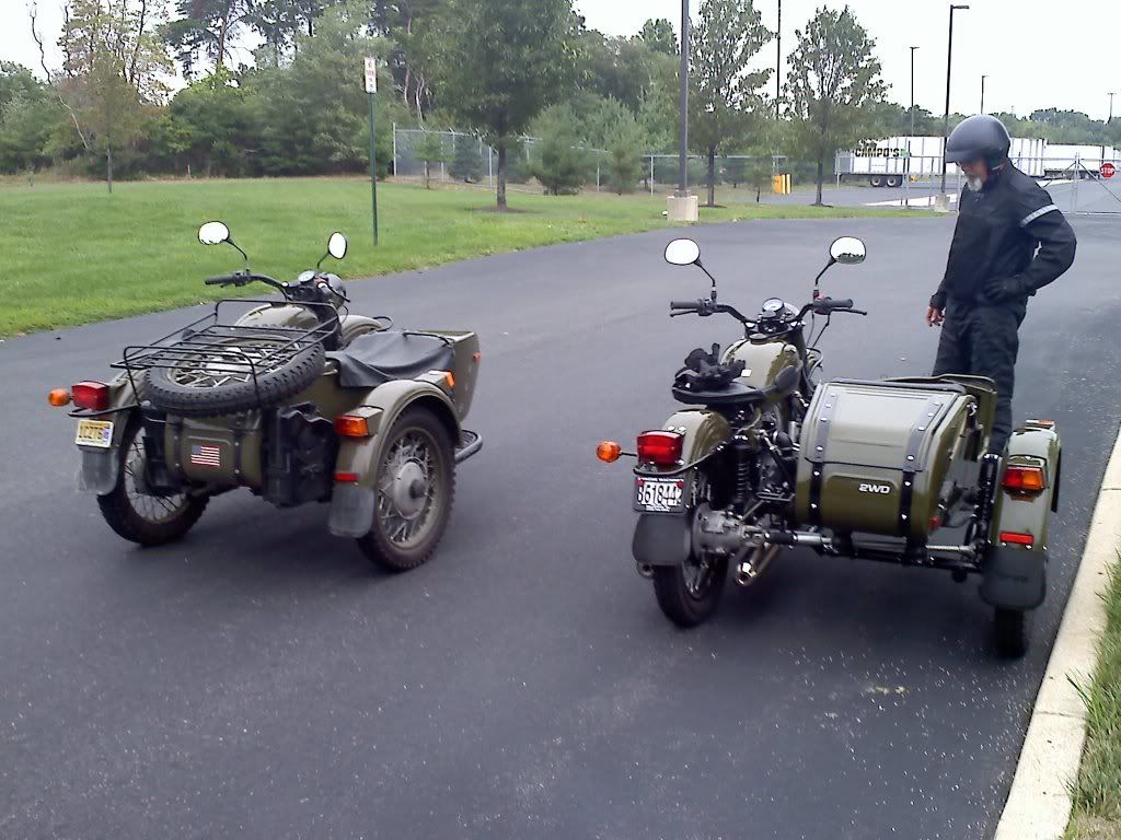

I highly suggest you try and find a local Uralista and swap advice.
Preferably have him follow behind you and give you some input as to how you are handling the bike.
I did that 10 years ago when NiteBlues came over to welcome me into the fold and it was a big help.
His bike was largely the same as mine, just a few years older.
Below is a pic from that ride and you can see minor differences in the angle of the frames, sidecar, lean etc.
He is the one who helped me realize I had way too much lean as set-up by the dealer.
Don't assume the dealer set-up is right for YOU, there is a lot of variation.
Do lots of back street and parking lot practice, get a feel for what the bike does and when, it will provide you with clues on what is "normal" and what to adjust.
I can say that at a typical Ural meet-up if there are 12 bikes you won't find two set-up the same.
But an experienced Uralista can jump on any bike and ride it just fine, but it will feel "weird" to them.
