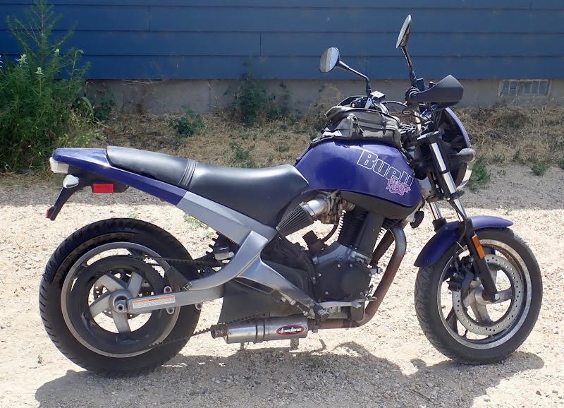

I have a 2004 Blast for my daughter-she really enjoys it!!
Got rid of the wonky autochoke and put a manual choke cable system on it with some carb internals from cv performance
starts right up now every time compared to 10-20 minutes of swearing at the auto choke with the silicone w@* pellet that wouldn't cooperate
I've never had a complaint with the auto-choke system. It's a carb'd bike that runs like an EFI bike, far as I'm concerned. It's weird on very rare occasions (mostly involving sitting long enough that the carb cools down but the engine hasn't), but... overall? It hasn't bothered me enough to rework.
Now, the carb shaking loose. That's a separate issue, and the blasted thing clearly hates having a carb present. I've remounted that thing so many times. I've got a SuperBoot for it, and the carb is currently supported by a couple springs as well.
That I removed the airbox and a bunch of other stuff might not have helped this. It's got a K&N cone filter, a custom intake with a splitter, a Jardine exhaust, most of the plastics missing...

Very nice setup on the blast
Have the super boot need to still install the springs
Have the Buell pro intake w/ k-n so very similar
They are really great little bikes
Problem is the jardine exhaust is so loud I would like to find a dB killer for the tail pipe outlet...

Post by Syonyk » Sun Oct 13, 2019 11:50 pm
I've got the quiet core insert. It helps quite a bit.
