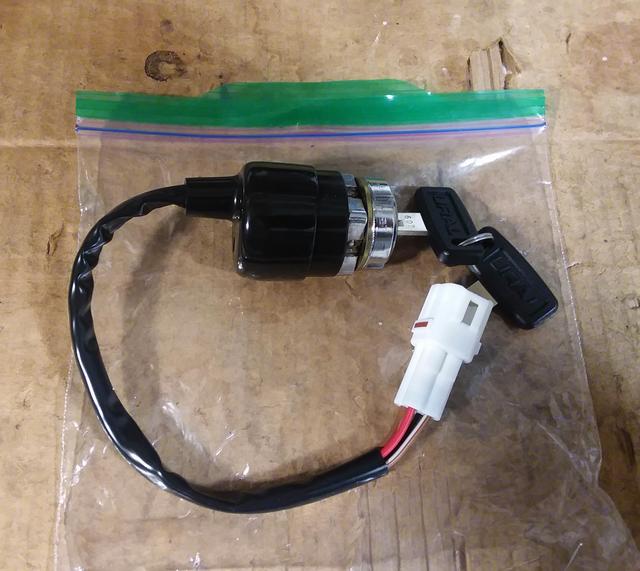

There was a recall issued for the ignition switches on 2018 Gear Ups. I just received a new switch from my dealer. The detents at each key position are indeed more positive/secure when compared to the operation of the original switch (which worked fine.)
I didn't ask what other models, or model years, were affected by the recall. It might be worth your time to do so with your selling dealer.

Not all 2018 had the switch issue, only a certain range of vins numbers. It was an issue where the wires connected to the backside.

Thanks for the clarification.heindlengineeringural wrote: ↑Sat Oct 13, 2018 9:30 amNot all 2018 had the switch issue, only a certain range of vins numbers. It was an issue where the wires connected to the backside.
What is "an issue where the wires connected to the backside" meant to mean?
