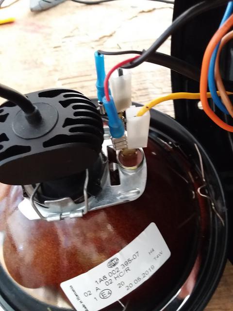

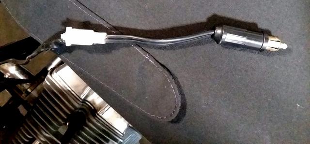

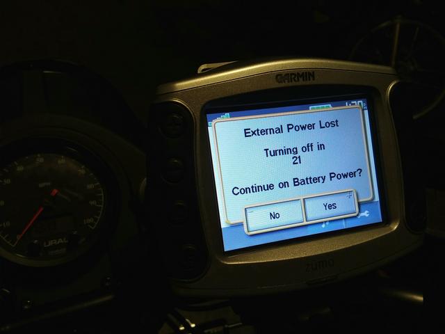

I sourced some electrical connectors that allowed me to [finally] hardwire the Garmin Zumo GPS cradle without any cutting or splicing, so that's the job I attended to today.
<<Let the scrolling commence>>

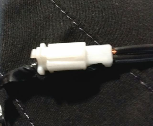

My existing power connection was via the OEM 12V outlet in the sidecar. I used a pair of MTW .110 connectors to bridge the gap between the Zumo's harness and the male Powerlet pigtail. Originally a rush job, it looked craptacular. Not up to my usual standard at all.

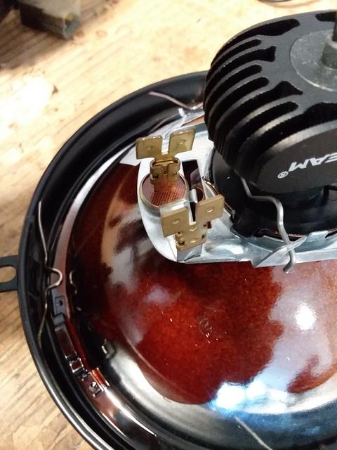

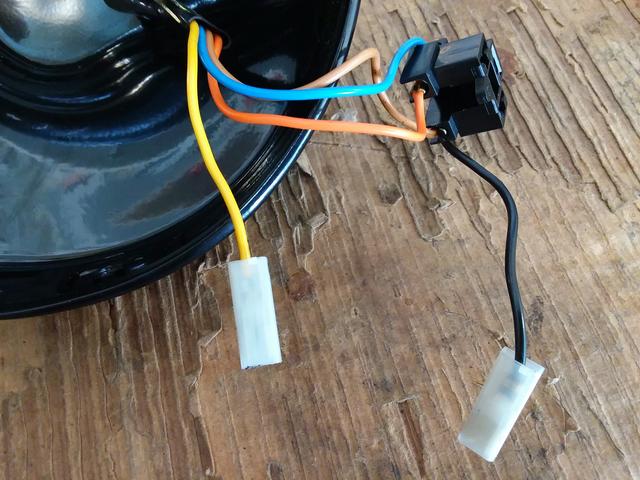

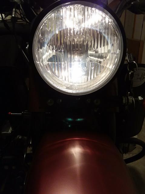

I identified the city light connections on the recently installed Hella E-code headlight shell as the preferred power connection for the Zumo.
Esoteric splitters were used to create four male connections from the two originals. Experience has proven that the Zumo's current draw is nominal, so I wasn't concerned about configuring the connection in this manner.

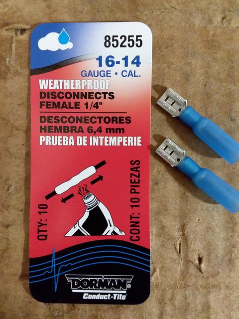

New female disconnects with integrated heat shrink sleeves would replace the MTW .110/Powerlet pigtail combination.
The disconnects required considerable heat to shrink them correctly. Proper care must be taken to avoid damaging any gauge of wire being used with them.
A two-for-one deal.
The cradle's power wire neatly twins with an existing wire that goes under the speedometer.
Time to test. The city light continues to correctly illuminate when the key is turned to the On and the Parking positions...
...whilst the Zumo boots up correctly after being concurrently energized.
When the key is turned to the Off position, the GPS then displays the correct prompt. Done and done.

It is pretty crowded in the headlight bucket. It would be a good idea to add a couple layers of tape or a layer of heat shrink to the female quick disconnects. Bare conductors seem to be highly attractive to their opposite polarity. I usually use shielded quick disconnects just for safety.
Already done, Nick. I'm an artiste with 3M Super 88. Thanks for the suggestion.
