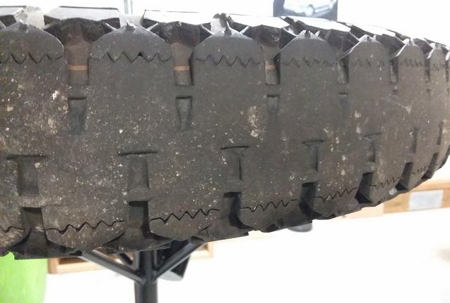

Changed the pusher. If I never see another 'heavy duty' tube it'll be too soon. I'm guessing they could put treads on those tubes and do away with tires.

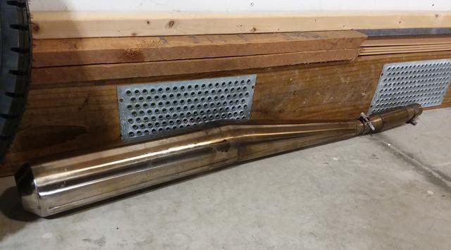

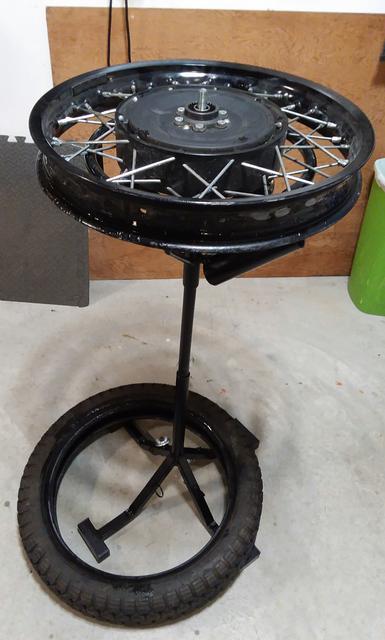

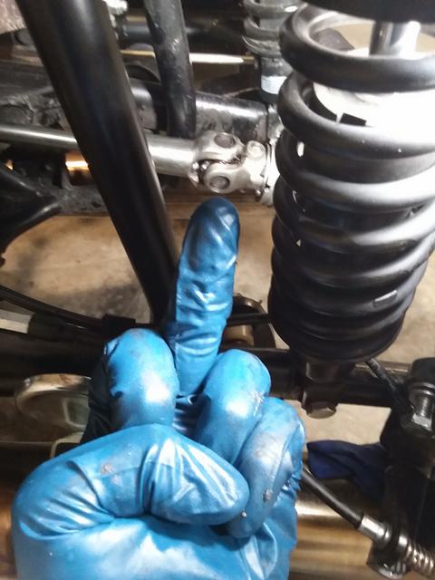

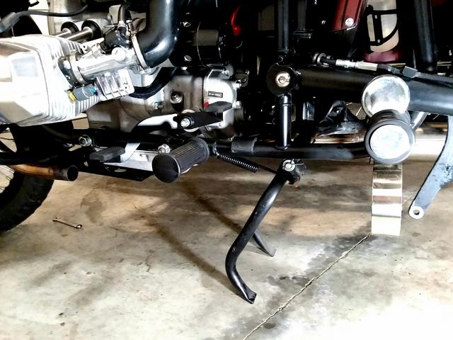

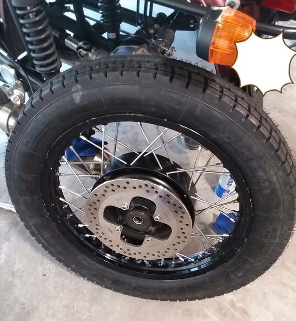

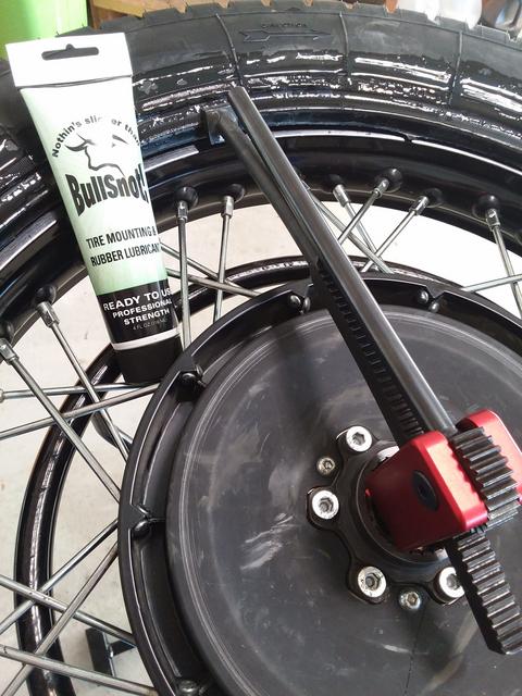

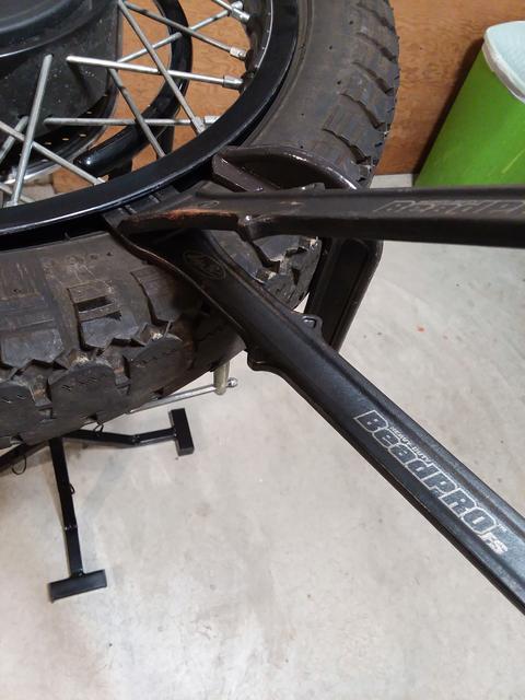

‘Twas a busy time here at Lofty’s Garage. Working slowly and fussily, as is my wont, the following was attended to:
A new Heidenau K28 pusher. Much love to the Baja No-Pinch tool, Motion Pro and BullSnot! for making the job go easier.

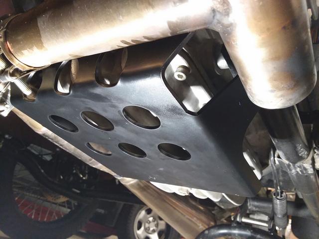

The outboard catalytic converter and muffler were necessarily removed in order to accommodate installation of the OEM sump skid plate.

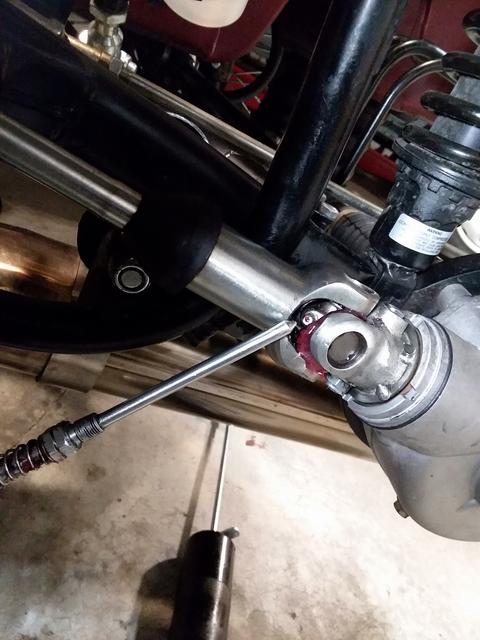

The needle grease tip successfully pinch hit for the Tecalemit grease pen, which is presently inoperative.
No love for the virtually inaccessible zerk on this particular U-joint.

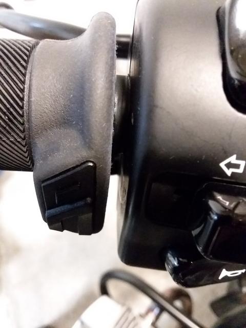

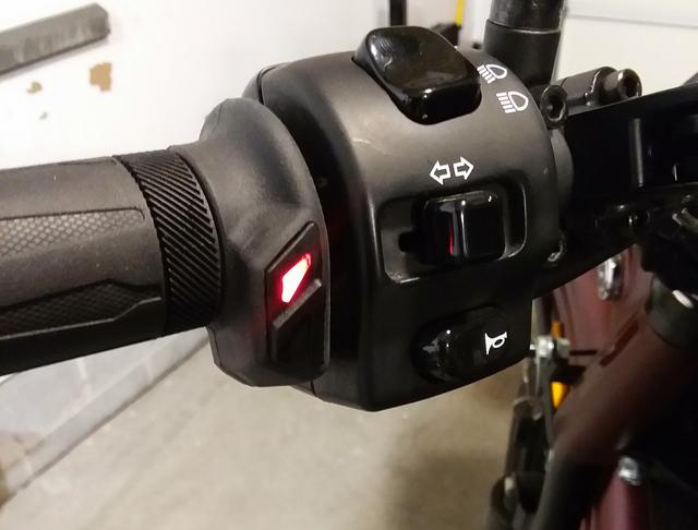

Next: Koso Apollo heated grips, to include a new throttle tube to speed the process a bit.

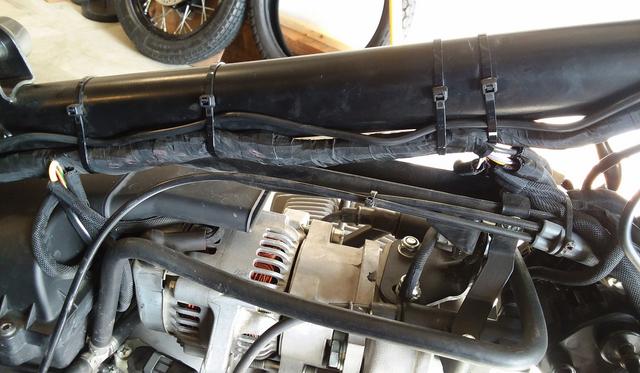

I simply followed the primary harness between the battery and the headlight when routing the grips’ power supply. For the sake of simplicity, the grips are wired directly to the battery. I'm pretty good about turning things off, and the Kosos claim to have a low-voltage protection feature.
The sharp eye will notice the location and appearance of the throttle cable splitter.
The Apollos fit VERY snugly on the stock handlebar. Percussive assistance with Mr. Mallet was necessary to get them seated fully.
The mild gap on the clutch side was necessary to allow installation of the end (trim) cap without fouling by a protruding handlebar. As I discovered during the shakedown ride, this gap serves to move my clutch hand just far enough away from the left switch pod to be mildly annoying. I’ll adapt.
I was glad to be able to co-locate the harness connections in a protected but easily-accessed area. They disappear when tucked in behind the headlight.
Tested functional. Five LED colors are used to illustrate the heat level. The grips get quite warm, but do so no faster than the BikeMaster heated grips on my Suzuki (which cost 58% less than the Apollos.) Meh. I was pleased to discover that the left grip gets and stays as warm as the right grip. The matter of heat imbalance with heated grips is a known issue; the right grip isn't in direct contact with steel or aluminum bars (as is the left grip), which acts as a heat sink. Koso seems to have solved this problem.

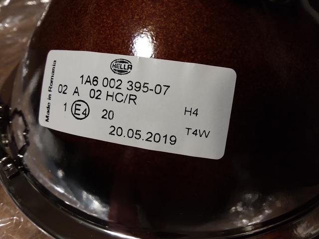

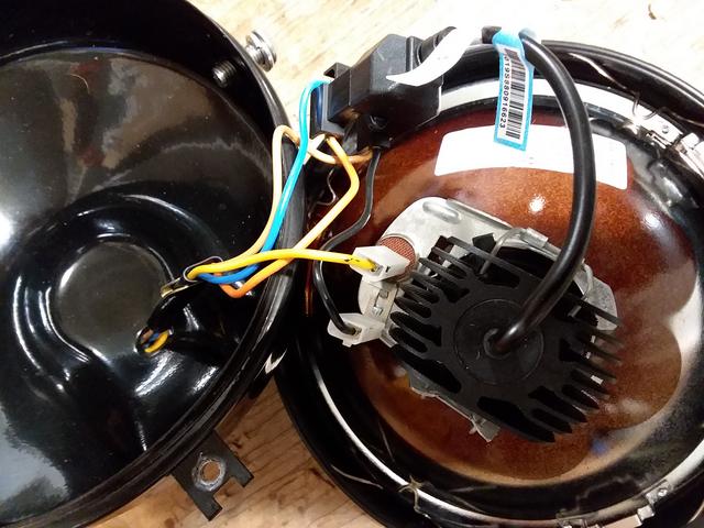

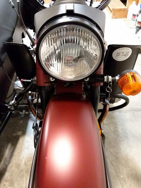

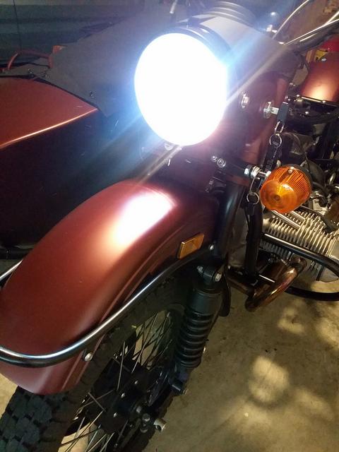

I’ve seen the light. Verily, it is Hella 7” E-code and Auxbeam NF-S1 LED.
Made in Romania? What is this unsinn?

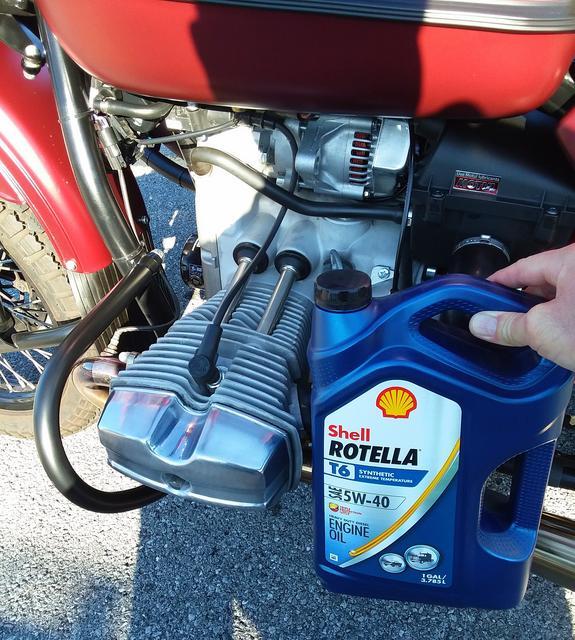

A fluids change is due in ~300 miles. Provided the prevailing temperature trends are low enough, I’ll likely add Rotella T6 5W-40 synthetic to serve as winter oil. That leaves just the Barkbuster Blizzard hand guards to complete the rig’s winter preps.
