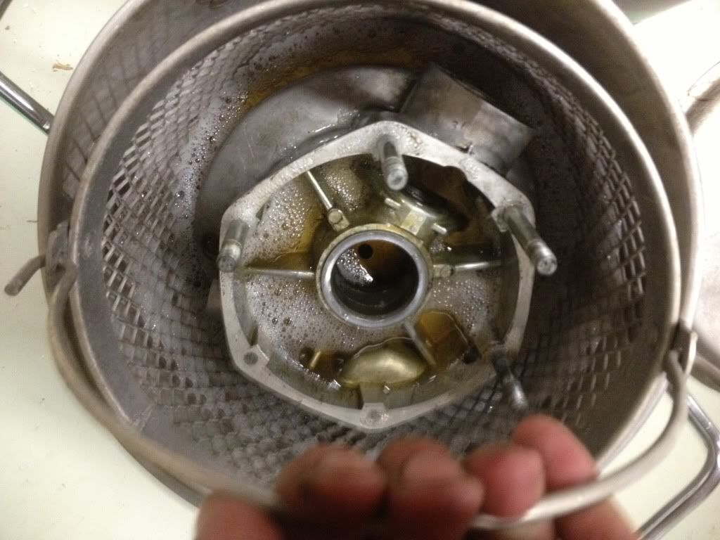

I did something similar with an old deep-fryer and some Pine Sol:
Image2014 Ural M70 "Trogdor"

Did the PineSol and crab pot thing with the FD.
Heated 1 part water and dumped in 2 parts PineSol
Worked well, did not discolor the aluminum.
It did flash rust the internal steel parts, like hubs and spacers, so the tip there is to rinse them under cold water and hit with WD-40 immediately.
Some folks have boiled the pot or put it on a burner to get it hot/maintain temp but I didn't find that to be necessary.
